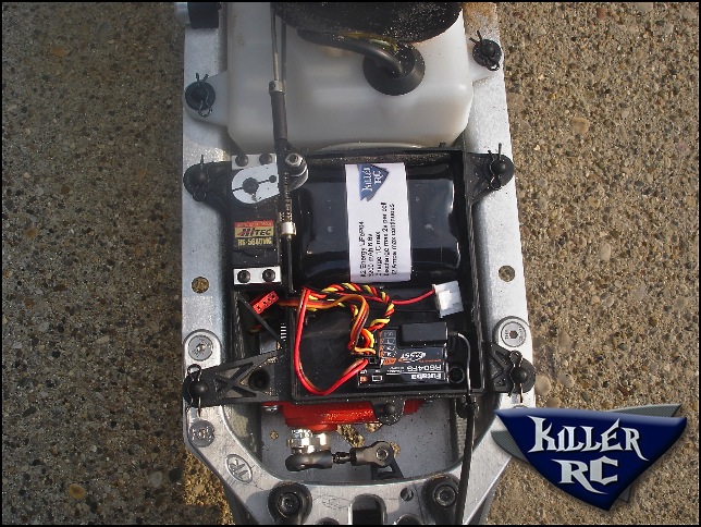

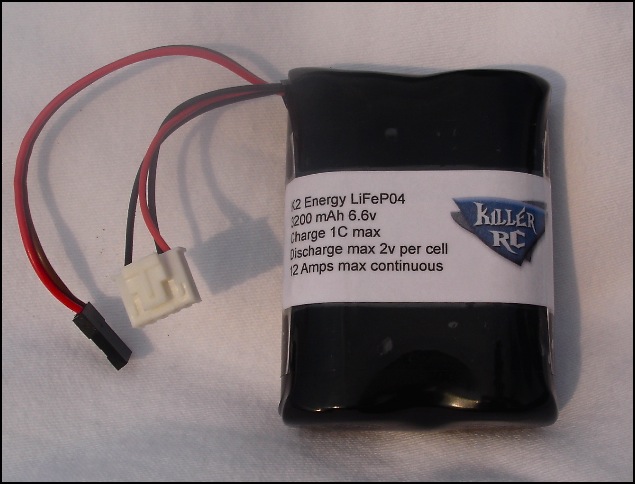

Li-Fi , Tror jag är bättre! This 6.6v 3200mAh LiFePO4 receiver battery pack is made with the latest in battery technology. This Lithium Iron Phosphate (LiFePO4) battery pack has all the advantages of Lithum Polymer (LiPo) batteries, but cheaper, safer, and easier to use than LiPo. You can use this battery pack as a direct replacement for your 6 volt, 5 cell NiMh or NiCd battery hump pack. This pack weighs 175g, which is about half the weight of a comparable NiMh pack. With this pack you will notice stronger and quicker servo response for a longer period of time. These LiFe cells have twice the shelf life (72 months), and twice the cycle life (2,000 cycles) of LiPo cells. With this pack you do not need to buy a voltage regulator or voltage cutoff. LiFe cells can handle lots of abuse and still remain safe and stable, unlike LiPo. This new battery technology is quickly being adopted for use in the automotive industry for electric cars. The demand for LiFe cells is expected to increase soon, so get some packs for your RCs now, before prices rise. This pack comes standard with a male Hitec style servo power plug, and Hyperion or Thunder Power balancing tap. You must have a battery charger that is A123 or LiFePO4 compatible. We store and ship the battery packs charged to 60% capacity. When not in use it is best to store this battery pack at 50-60% capacity for maximum battery life and performance. When using this pack in a HPI Baja you may need to trim some plastic off of the two nubs on the underside of the battery box lid.
For a great deal on Hyperion LiFe battery chargers just email nate@rcnhobbies.com and ask for the Killer RC discount price, and free shipping.
The 6.6v 3200mAh LiFePO4 receiver battery pack is $49.
